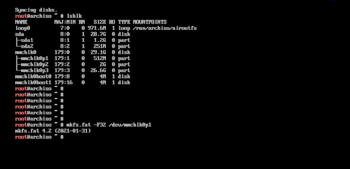

  1. Disk Partitioning (GPT)
This guide assumes that the system will be installed on the onboard eMMC device.
⚠️ The installation process will partition and format the onboard eMMC. Please ensure that there is no important data stored on the eMMC before proceeding.

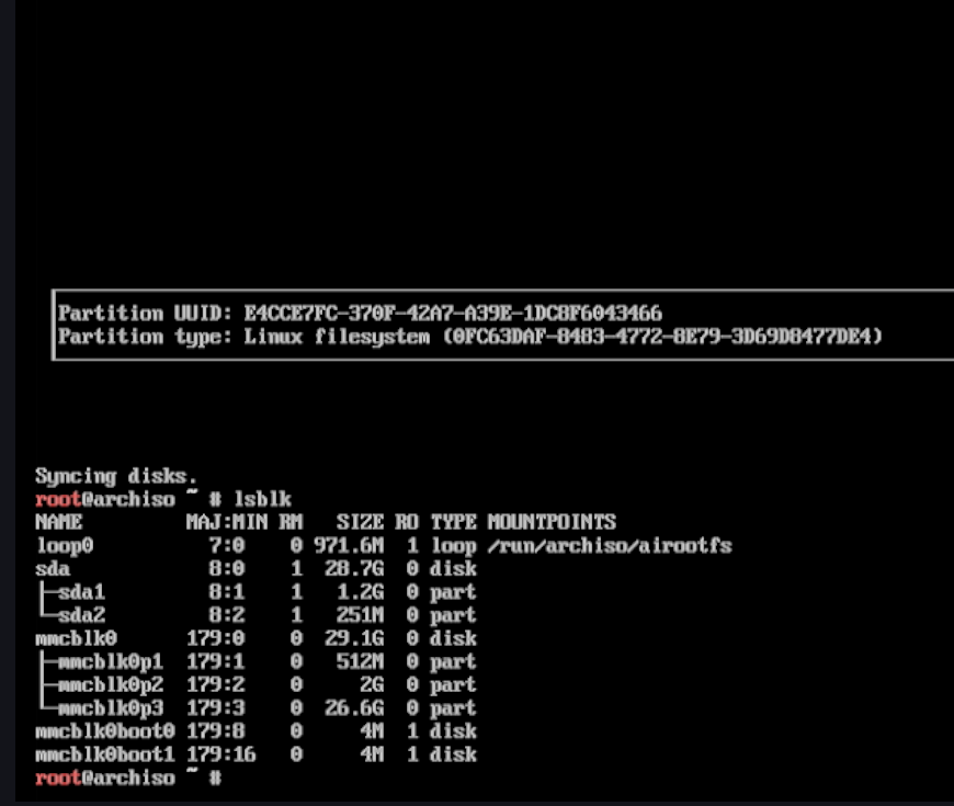

View Disk Information
lsblk
Run the following command to view disk and partition information in a tree structure:
View disk information

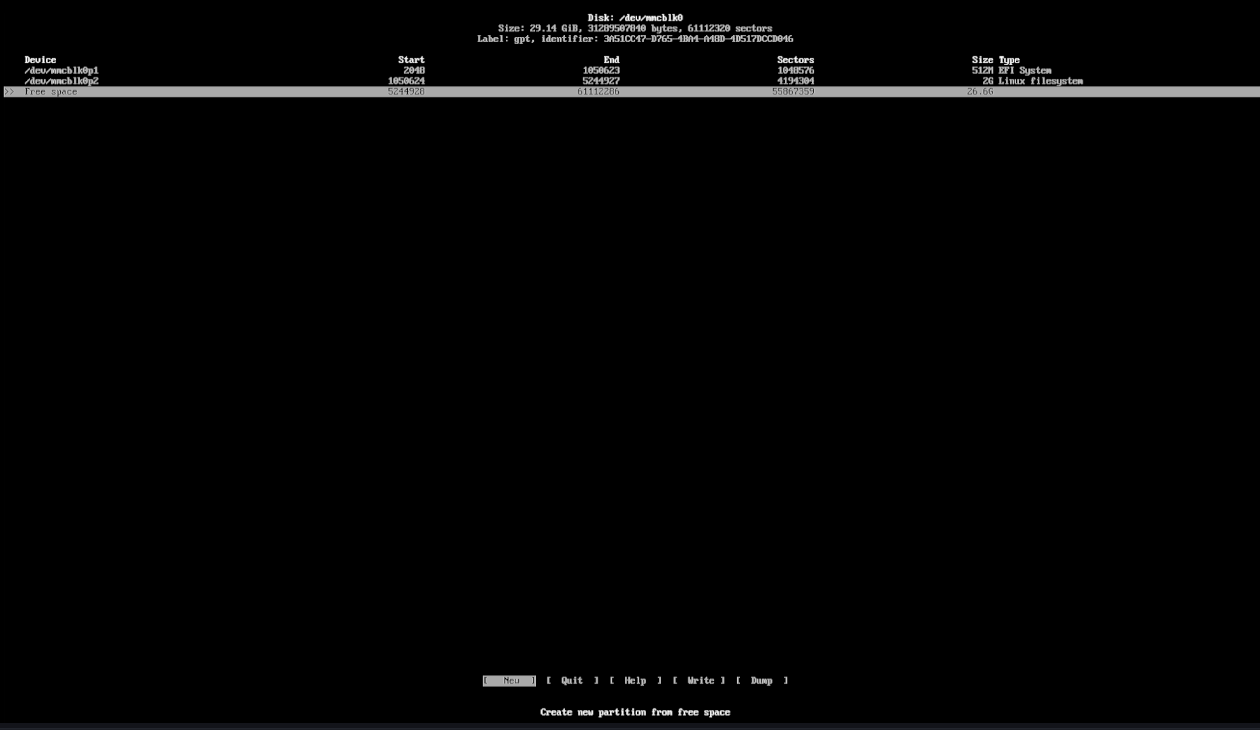

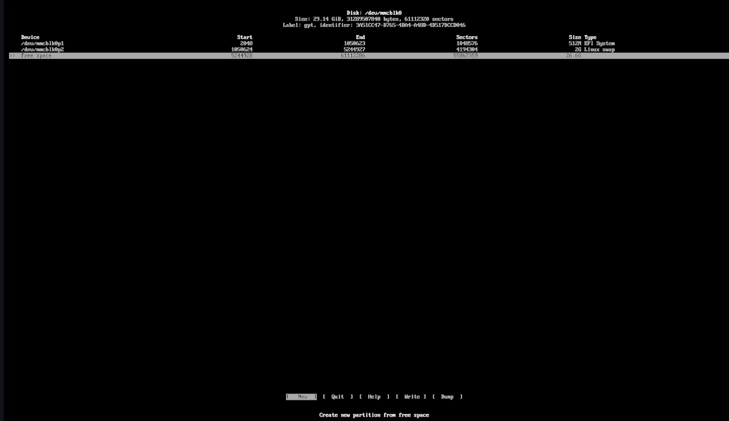

Create the Second Partition (Swap)
① Select the Free Space
Use the arrow key to select:Free space 28.6G
② Create a New Partition
  • Use the right arrow key (→) to move to the bottom menu.
  • Highlight [NEW].
  • Press Enter.
③ Specify the Partition Size
When prompted for the size, enter:2G
Enter 2G
④ Set the Partition Type to Linux Swap
  • Select the newly created ~2 GB partition.
  • Enter [Type].
  • Choose Linux swap.
Set the partition type to Linux swap.

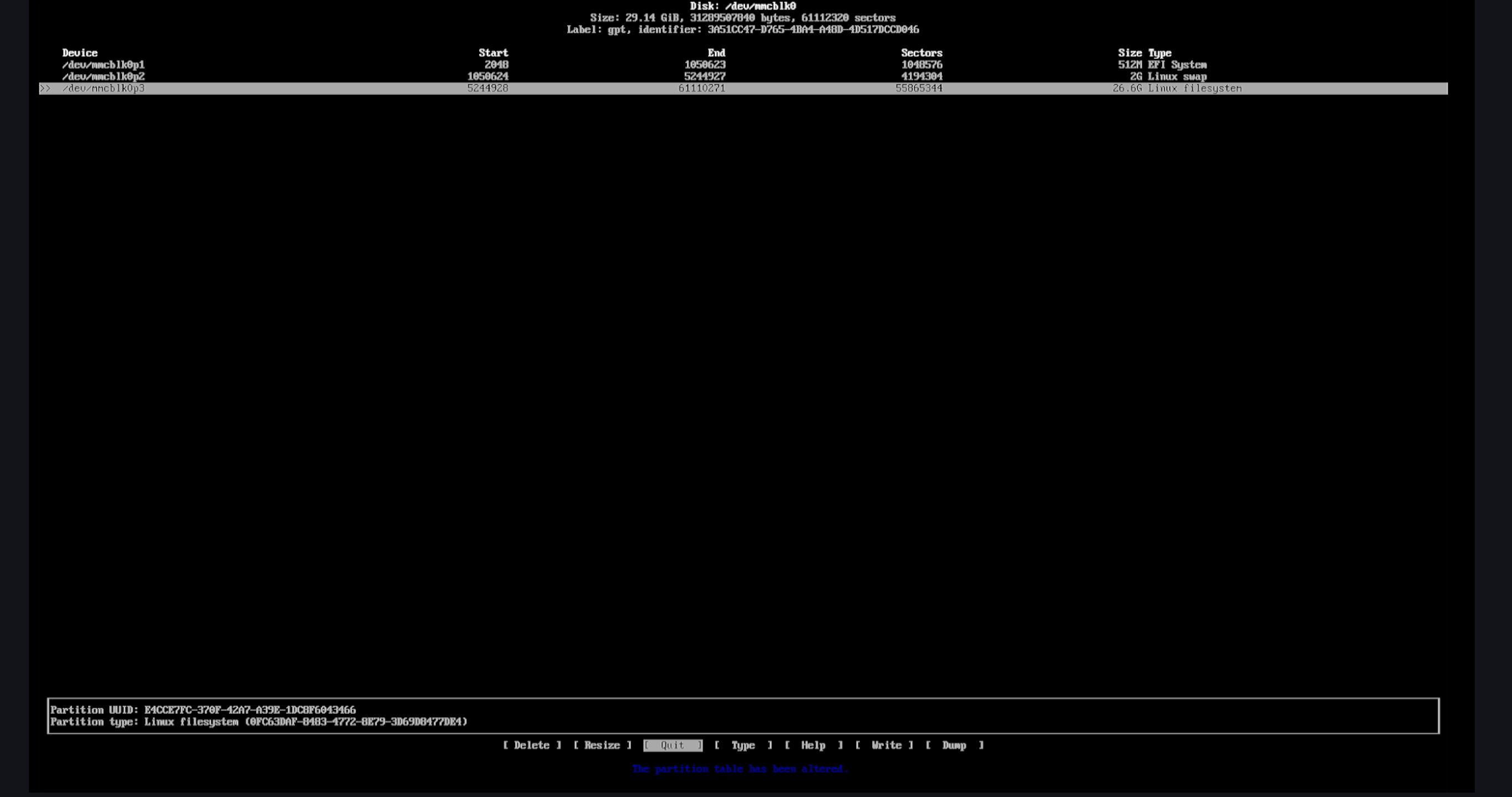

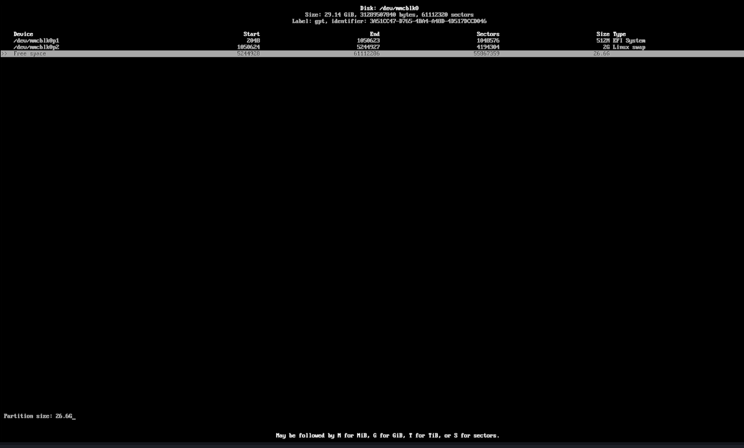

Create the Third Partition (Root)
① Select the Remaining Free Space
You should now see:
Free space 26.6G
Keep this entry selected.
Create the third partition (Root).
  • Select [NEW].
  • Press Enter.
Select the 3rd partition (Root).
③ Use All Remaining Space
When prompted for the partition size:
Do not enter anything. Simply press Enter to use all remaining space.
Create new partition

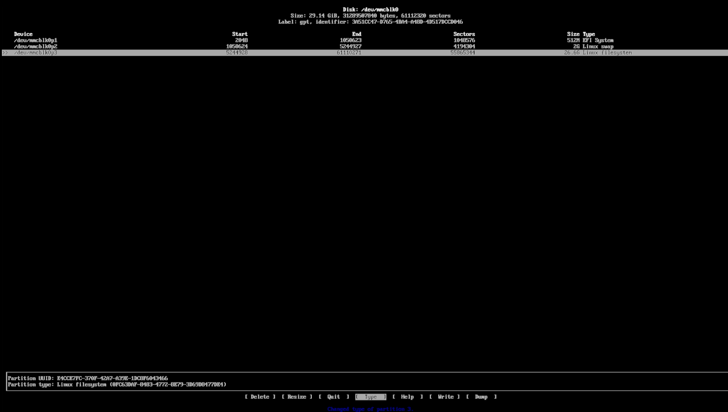

After the partition is created:
  • The default partition type is Linux filesystem.
  • In most cases, no change is required. Keep the default.
Default partition type

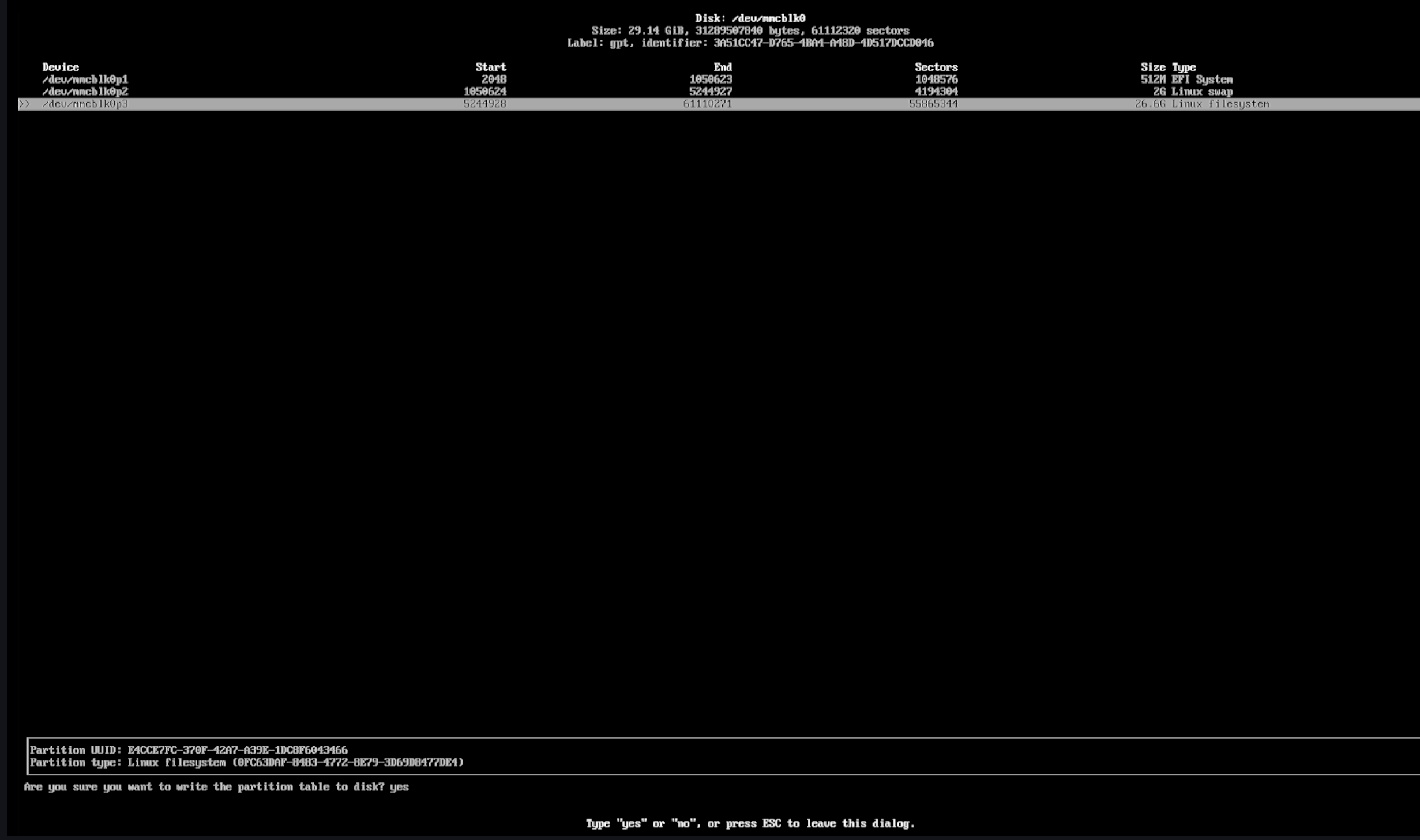

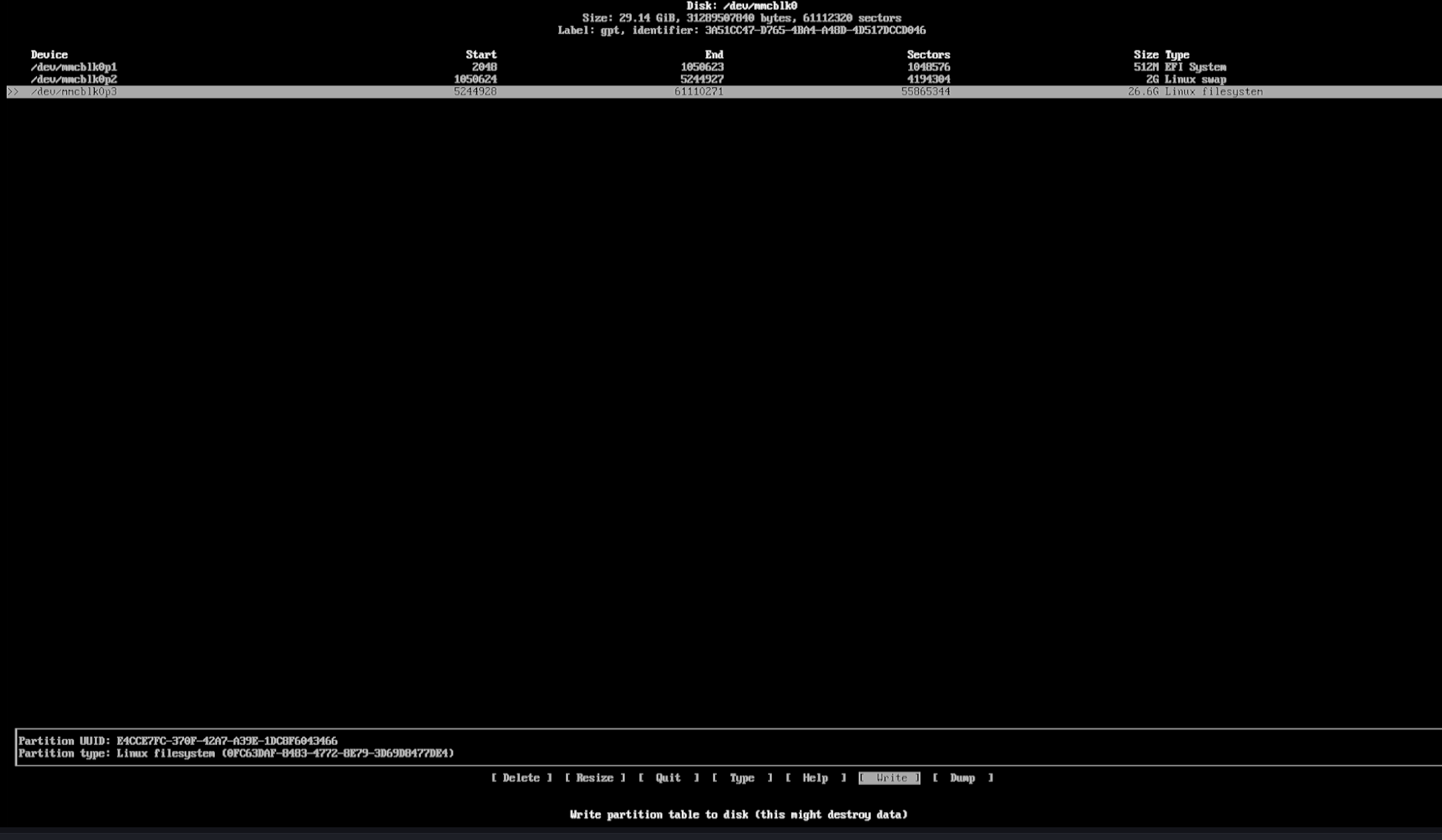

Write the Partition Table and Exit
  • Select [Write].
Write to partition table
  • Press Enter.
  • When prompted, type:yes
Confirm writing
Exit cfdisk
  • Select [Quit].
Exit cfdisk
  • Press Enter.
Partitioning Summary
At this point, disk partitioning is complete. You should have the following layout:
Size Partition type
mmcblk0p1 512M EFI System
mmcblk0p2 2G Linux swap
mmcblk0p3 26.6G Linux filesystem
Partition completed

  1. Format Partitions
In simple terms:
  • Formatting = clearing a partition and preparing it for use
  • Mounting = telling the system how these partitions should be used
① Format the EFI Partition (FAT32)
Run the following command to format mmcblk0p1:
mkfs.fat -F32 /dev/mmcblk0p1
Format partition

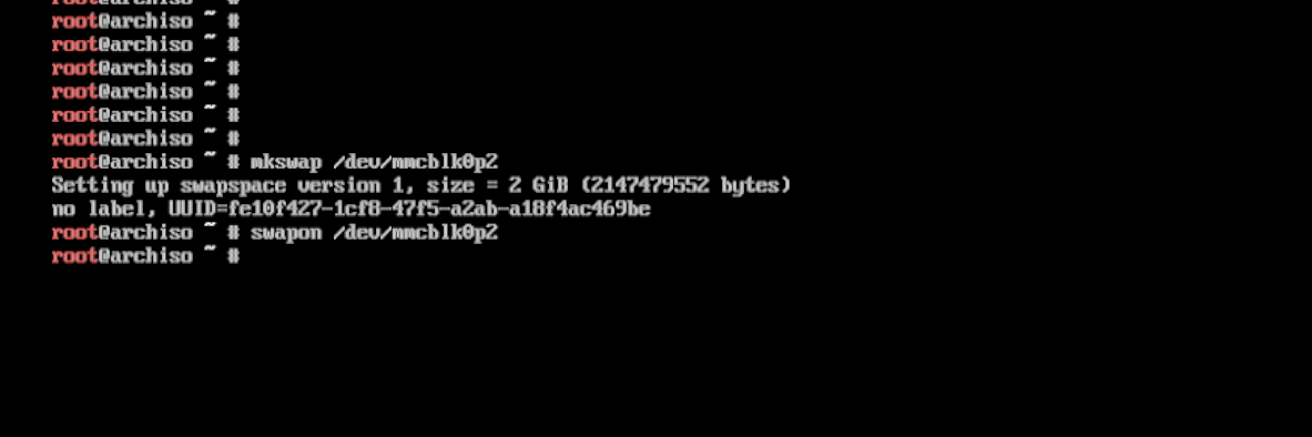

② Initialize and Enable the Swap Partition
mkswap /dev/mmcblk0p2
swapon /dev/mmcblk0p2
Initialize and enable partitions

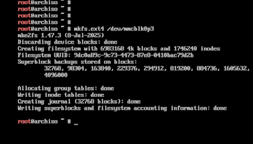

③ Format the Root Partition (ext4)
mkfs.ext4 /dev/mmcblk0p3
Format root partition

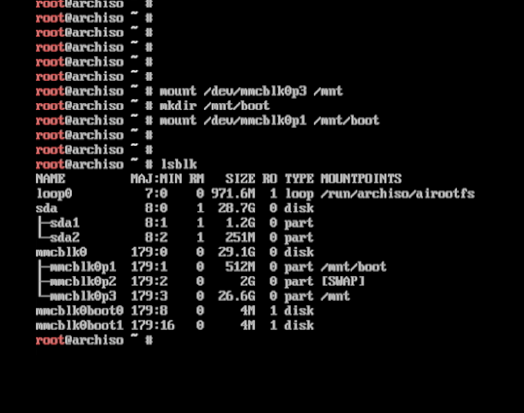

  1. Mount Partitions
Mount the Root Partition to /mnt
mount /dev/mmcblk0p3 /mnt
Create and Mount the EFI Partition
mkdir /mnt/boot
mount /dev/mmcblk0p1 /mnt/boot
Create and mount the EFI partition

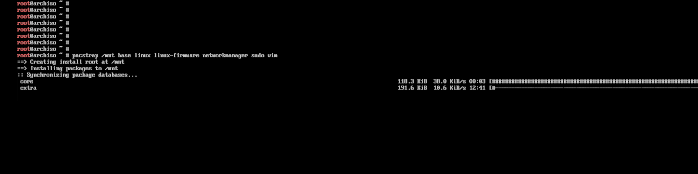

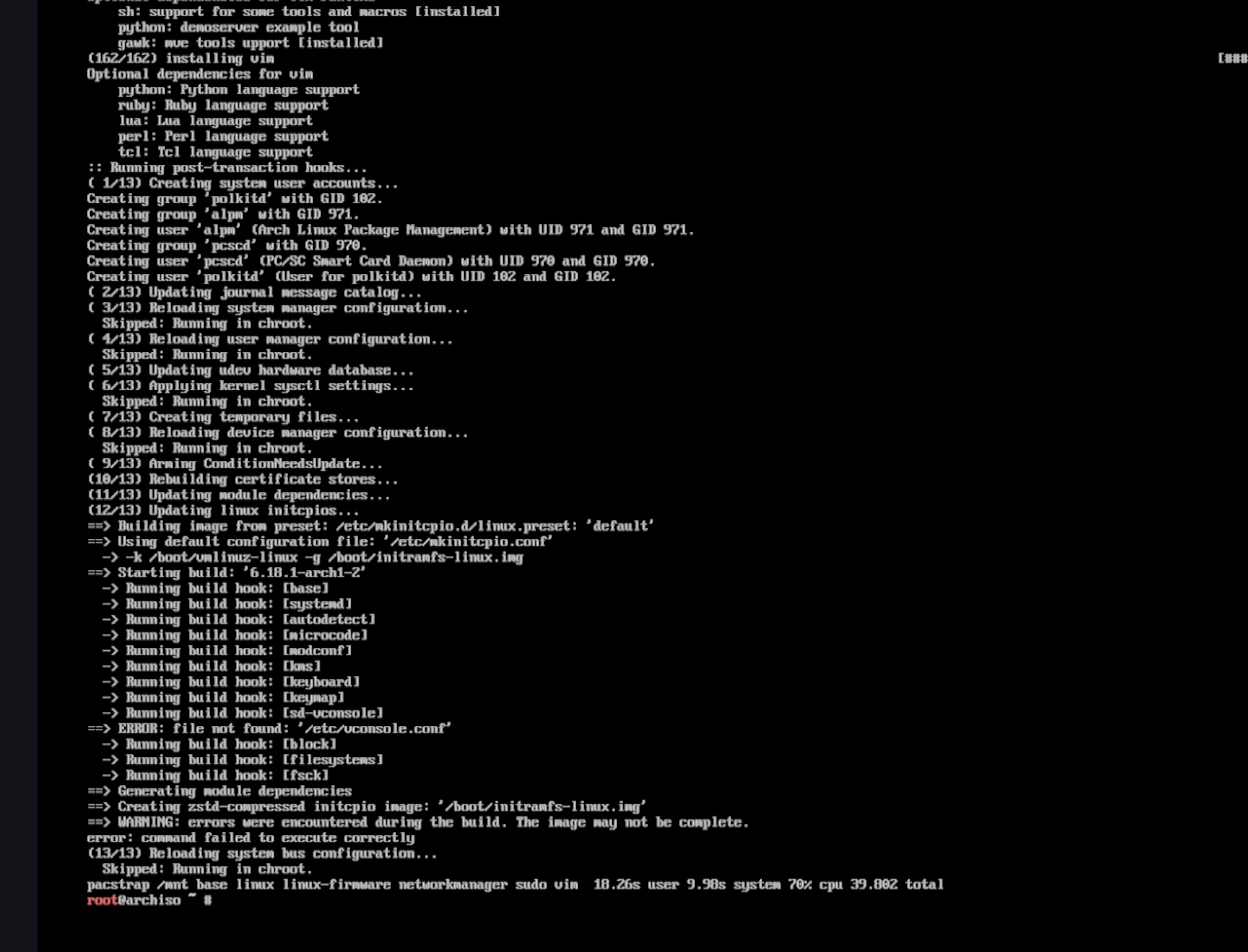

VI. Installing Arch Linux (pacstrap)
  1. Run pacstrap
    pacstrap /mnt base linux linux-firmware networkmanager sudo vim
Parameter explanation (for reference):
  • base: Minimal Arch Linux system
  • linux: Standard Linux kernel
  • linux-firmware: Hardware firmware (required)
  • networkmanager: Network management tool
  • sudo: Privilege management for non-root users
  • vim: Text editor (used for later configuration)
This step will download and install packages. The duration depends on network speed. A large amount of output during the process is normal.
Execute pacstrap
pacstrap execution complete

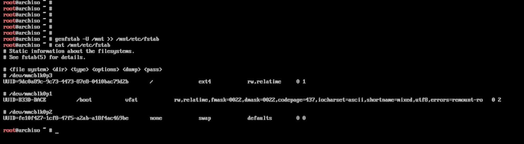

  1. Generate the fstab File
Generate the filesystem mount table for the new system:
genfstab -U /mnt >> /mnt/etc/fstab
Generate fstab file

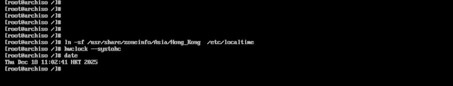

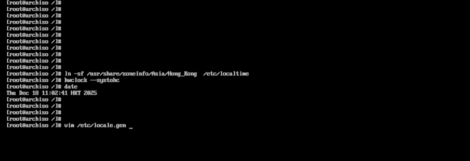

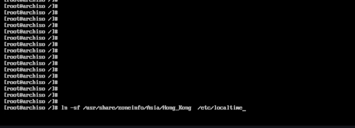

  1. Set the Time Zone
Using Hong Kong as an example:
ln -sf /usr/share/zoneinfo/Asia/Hong_Kong /etc/localtime
Synchronize the hardware clock (very important):
hwclock --systohc
Synchronizing hardware clock
Quick verification (optional)
If the time is shown as UTC+8 (Hong Kong time), the configuration is successful.
Hardware clock synchronization successful

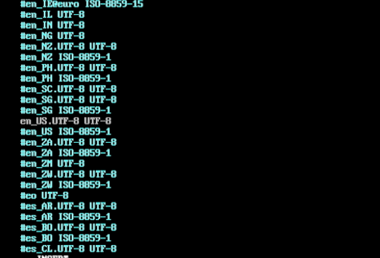

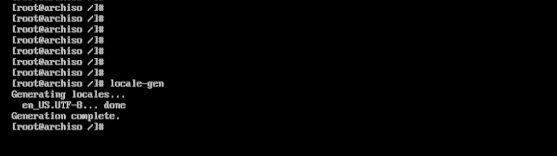

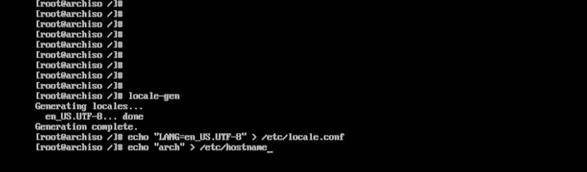

  1. Configure Locale (Language)
① Edit the locale list
Open the locale configuration file:
vim /etc/locale.gen
Set language
Find the language you want and uncomment the corresponding line (remove the leading #). Example for English (United States):
en_US.UTF-8 UTF-8
Set language en_US
Save and exit:
  • Press Esc
  • Type :wq
  • Press Enter
② Generate locales
locale-gen
Generate locale
  1. Set the Hostname
Set the system hostname. You may replace it with any name you like. Here, arch is used as an example (you can choose a different name):
echo "arch" > /etc/hostname
Set system hostname

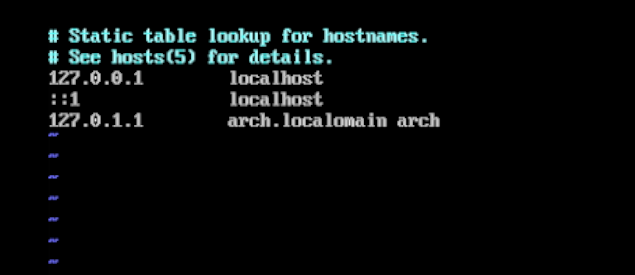

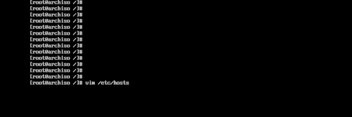

Next, configure the hosts file:
vim /etc/hosts
vim hosts
Modify the file as follows:
127.0.0.1   localhost
::1         localhost
127.0.1.1   arch.localdomain arch
hosts example
⚠️ If your hostname is not arch, replace arch in the above lines with the hostname you actually set.

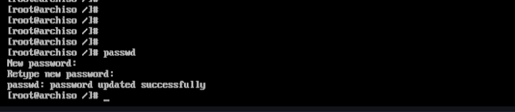

  1. Set the Root Password
Set a login password for the root user:
passwd
The system will prompt you to enter the password twice:
  1. Enter the new password
  2. Re-enter it to confirm
⚠️ Notes:
  • No characters (not even *) will be displayed while typing the password — this is normal.
  • Make sure both entries match.
Once completed, you can log in as root using this password.

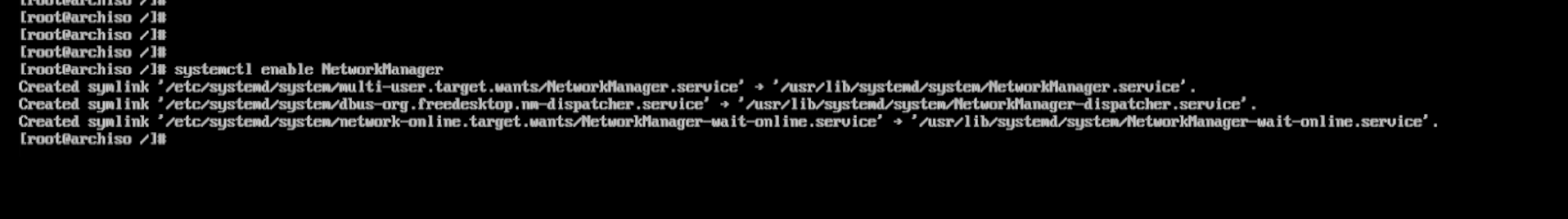

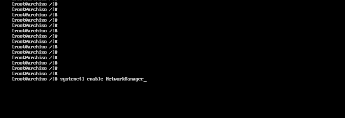

  1. Enable Network Service
Enable NetworkManager to start automatically at boot:
systemctl enable NetworkManager
Enable network services
Network service enabled successfully

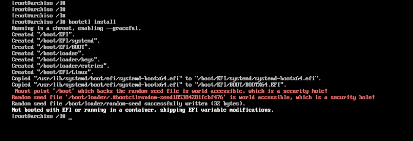

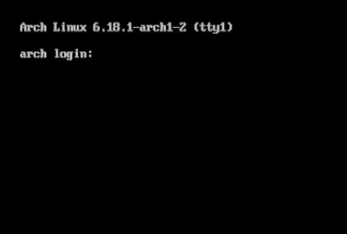

VIII. Install and Configure the systemd-boot Bootloader
  1. Install systemd-boot
Simply run:
bootctl install

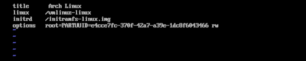

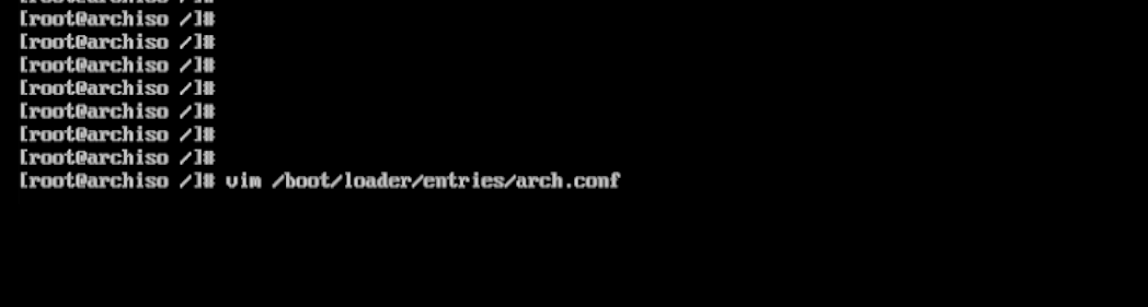

  1. Create an Arch Linux Boot Entry
You need the following file:
/boot/loader/entries/arch.conf
This file tells systemd-boot:
  • Where the kernel is
  • Where the initramfs is
  • Which partition is the root filesystem

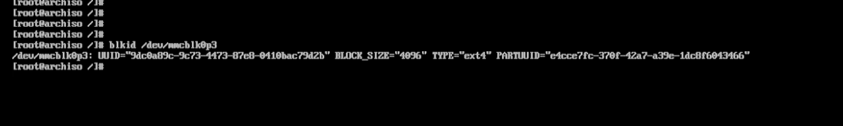

① Obtain the PARTUUID of the root partition
blkid /dev/mmcblk0p3
You should see output similar to:
/dev/mmcblk0p3: PARTUUID="12345678-9abc-def0-1234-56789abcdef0"
Copy and note the value inside the quotes.
Write down PARTUUID.
② Create the boot entry configuration file
vi /boot/loader/entries/arch.conf
Create startup configuration file
Enter insert mode (press i) and enter the following content:
⚠️ Replace YOUR_PARTUUID with the actual value obtained in the previous step.
title   Arch Linux
linux   /vmlinuz-linux
initrd  /initramfs-linux.img
options root=PARTUUID=YOUR_PARTUUID rw
arch.conf example
Save and exit:
  • Press Esc
  • Type :wq
  • Press Enter

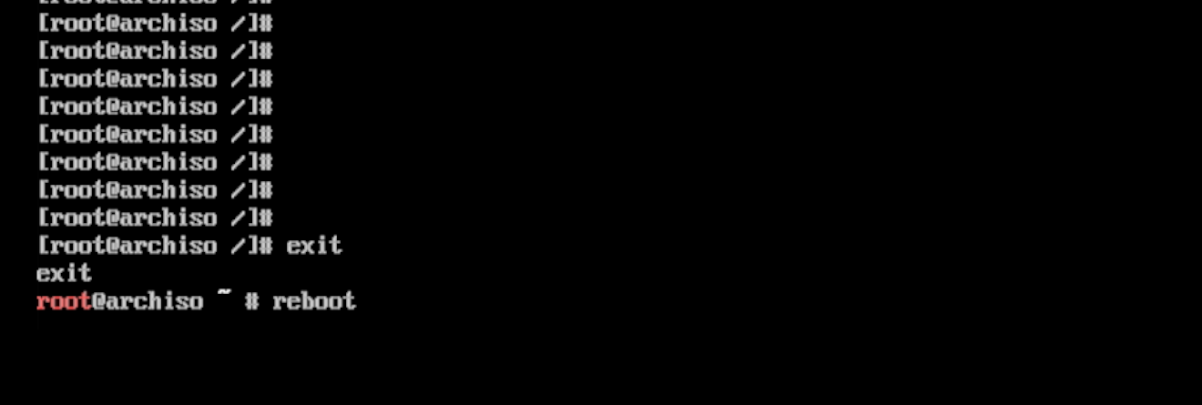

IX. Finish Installation and Reboot
Exit chroot
Leave the chroot environment:exit
Exit the chroot environment
Reboot the system
reboot
⚠️ Before rebooting, make sure to remove the installation media (USB drive / ISO).
Restart the system
Installation Complete
After a successful boot, you should see a screen similar to the following:
Installation completed
