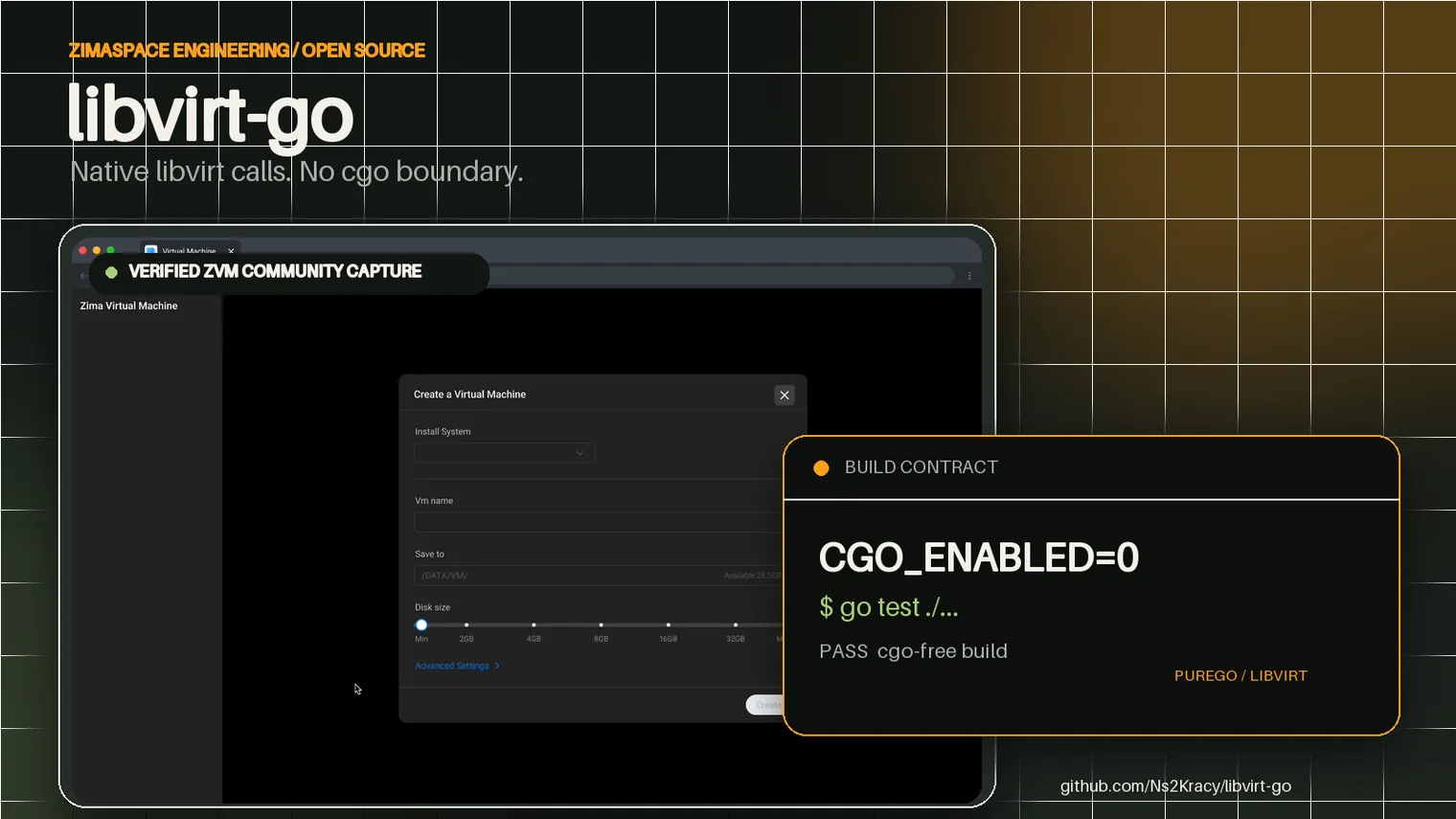

Today, ZimaSpace Engineering is sharing libvirt-go, an experimental developer preview of a cgo-free Go binding for libvirt built with purego. The project grew from our work on ZVM and the practical needs of home-server virtualization, where users create and manage machines for workloads such as Home Assistant OS, Windows, and pfSense. We are publishing the library now so Go and libvirt developers can inspect the approach and help test its boundaries. libvirt-go does not ship in any released ZimaOS build. It remains an independent experiment that we intend to use incrementally to improve the existing ZVM backend.
The Problem I Faced While Building ZVM
While building ZVM, I needed Go code to define, start, stop, inspect, and delete virtual machines through libvirt. Those operations support the ordinary lifecycle behind home-server VMs, including attaching storage and configuring network interfaces. I wanted the backend to cover more of that lifecycle without making release builds harder to produce.
The primary problem was cgo cross-compilation. I wanted release cross-builds to run with CGO_ENABLED=0, which excludes cgo code from the build. A cgo-based binding requires more than a Go compiler when a developer builds ZVM for another target. The build machine also needs libvirt development headers, pkg-config metadata that points to them, and a working C compiler for the target platform. Each dependency adds host and target assumptions to a release pipeline that should produce consistent Go binaries.
I also had to account for the libvirt version installed on each target system. One machine may expose a symbol or API that an older installation lacks. Compile-time checks against one set of headers cannot describe every runtime we need to handle. The Go API therefore needs deliberate coverage, runtime version awareness, and clear behavior when a function is unavailable. Resource ownership matters too: VM, connection, and callback handles need explicit release rules so long-running lifecycle operations do not leak native resources.
That experience led me to build libvirt-go with purego, loading libvirt dynamically and calling it without cgo. I started it as an independent experiment inspired by ZVM, and I intend to adopt useful pieces incrementally in the existing backend after testing. No released ZimaOS build ships this integration today.

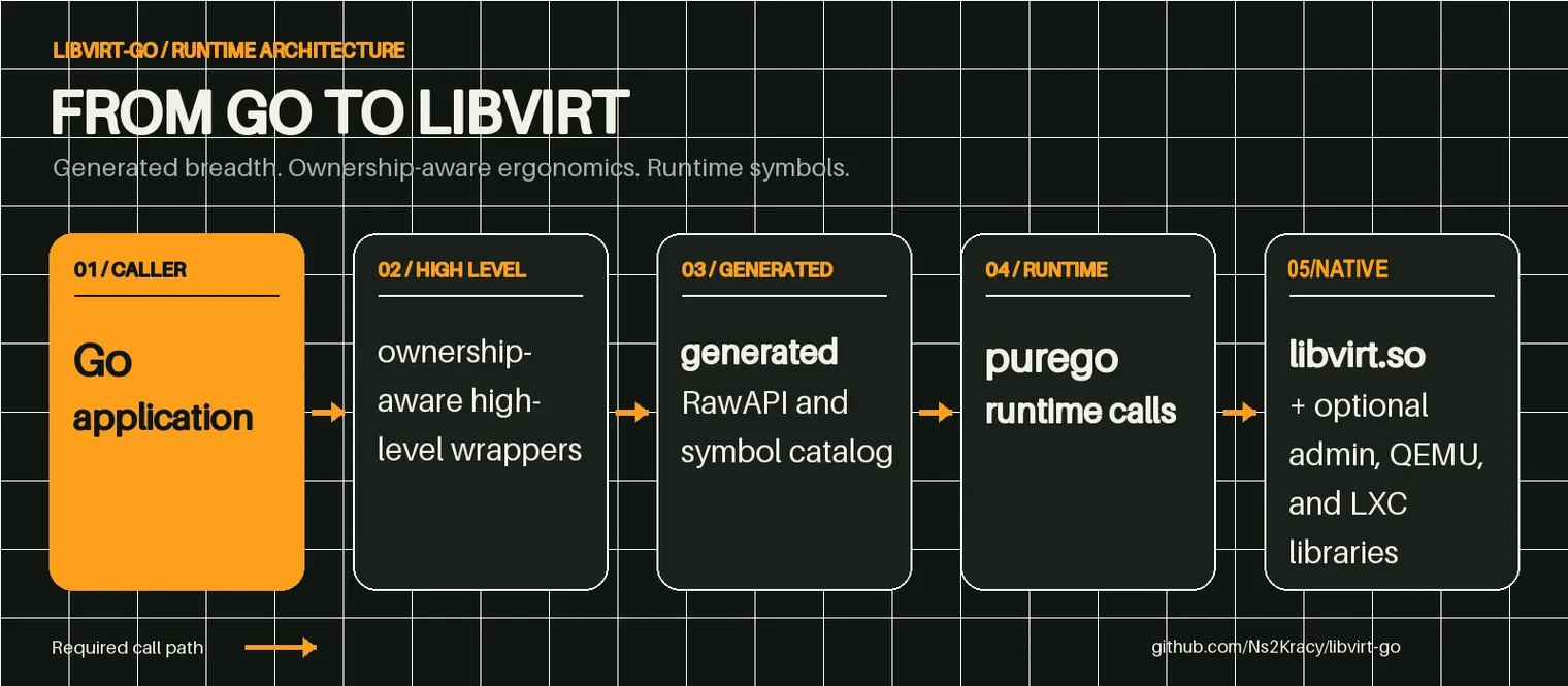

libvirt-go has a generated low-level layer and a handwritten high-level layer. At runtime, purego opens the native libvirt shared library and binds C symbols to Go-callable functions. This keeps cgo out of the application build, while libvirt continues to run in the same process. A compatible libvirt shared library is therefore still required on the machine that runs the program.
libvirt-go architecture from a Go application through high-level wrappers, generated RawAPI bindings, and purego to native libvirt libraries.
The generator reads the official API XML metadata vendored in this repository from libvirt 12.6.0. Across the main, admin, QEMU, and LXC APIs, that metadata produces exactly 568 functions and 1,093 enums. The generated surface exposes public RawAPI methods with types suitable for purego. Its catalog also records source-library routing, so each function is looked up in the main libvirt library or its admin, QEMU, or LXC extension library. Generated symbol registration data connects names to call targets, and introduction versions record when upstream libvirt added each function. Missing extension libraries affect their own symbols without preventing the main library from loading.
Generation supplies breadth, while the handwritten wrappers supply behavioral rules that XML declarations alone cannot express. These wrappers track ownership of connections, domains, streams, and other native handles. They copy allocated return values into Go data and release native allocations where required. They also preserve Go values for the lifetimes needed by native calls, manage callback registration and cleanup, and turn libvirt’s thread-local error records into structured Go errors. These details matter because a successful call can transfer a reference, return memory that needs release, or register work that remains active after the call ends.
Compatibility is visible to callers instead of being hidden in the loader. HasSymbol reports whether the loaded libraries export a generated function. SymbolVersion reports the upstream version that introduced a known symbol. When a requested function is absent, generated raw calls and high-level calls return a SymbolUnavailableError. That error wraps ErrSymbolUnavailable, so normal Go error inspection can recognize the shared condition while retaining the symbol name and introduction version.
This symbol-by-symbol model supports older libvirt installations and distribution backports. It relies on what the runtime library exports rather than treating its numeric version as a complete capability list. RawAPI remains available for specialized operations that lack a high-level wrapper, but raw callers retain responsibility for C failure sentinels, native ownership, and thread-local error handling. The high-level layer is the safer starting point for application code.

From the repository root, run the example with cgo disabled on a supported
Linux machine with libvirt installed:
CGO_ENABLED=0 go run ./examples/list-domains
test:///default is libvirt’s synthetic test driver. It supplies sample resources and does not alter real guests. The build does not need libvirt development files. The program still requires a compatible libvirt shared library at runtime.
