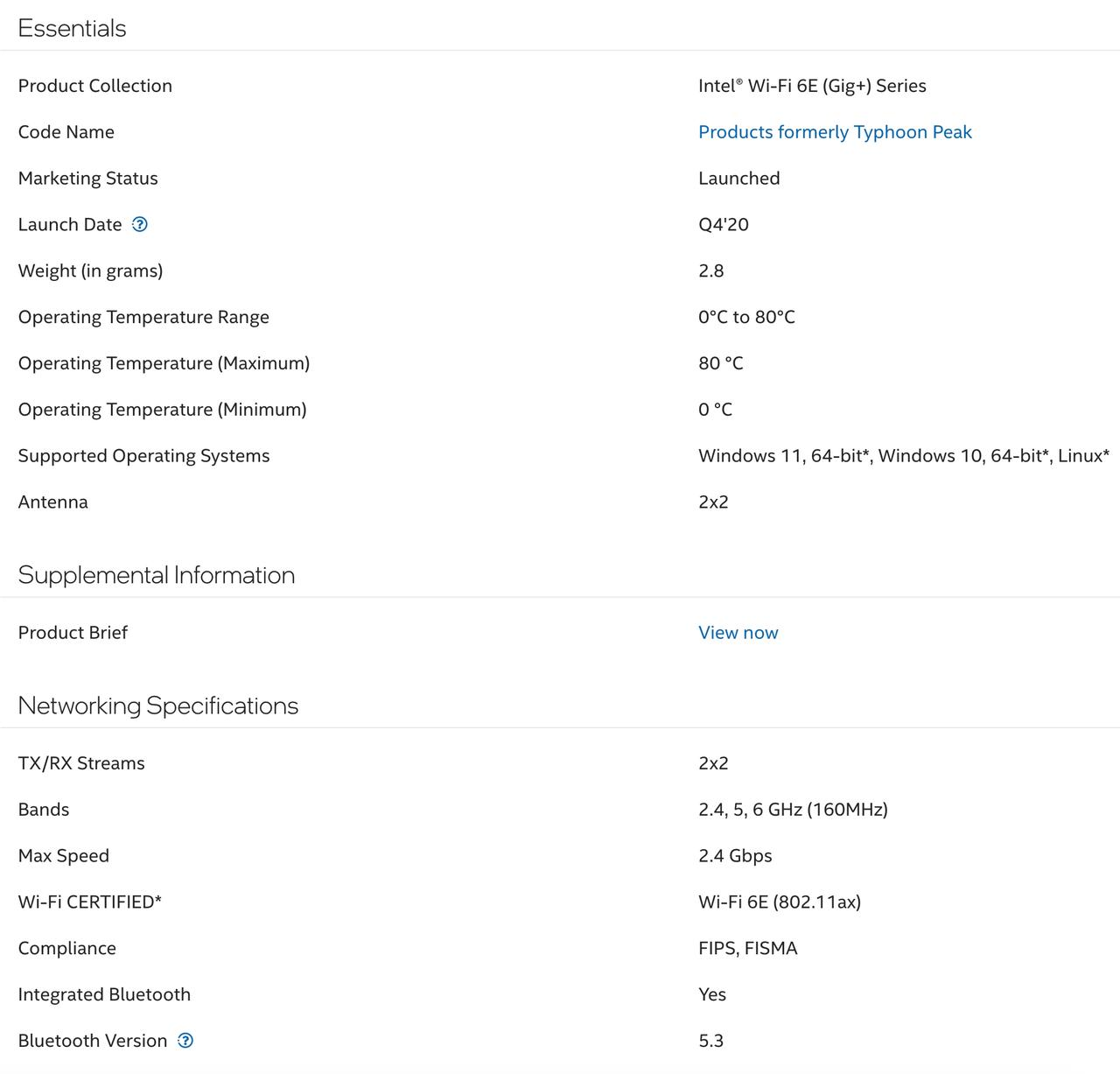

The Intel® Wi-Fi 6E AX210 (Gig+) adapter is designed to support Wi-Fi 6E technology. The product supports dual-stream Wi-Fi in the 2.4GHz, 5GHz and 6GHz bands as well as Bluetooth® 5.3. Combined with Intel® Core™ processors and exceptional Intel wireless innovations, the Intel® Wi-Fi 6E AX210 module can dramatically improve your connected experience at home, work, or on the go.

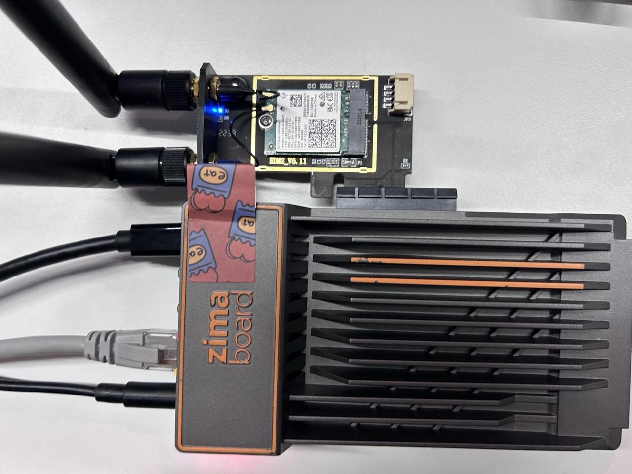

A. Insert the AX210 card into the ZimaBoard.

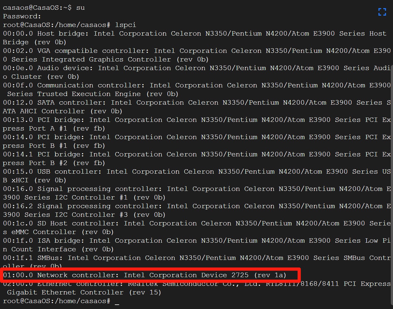

Step 1: Check if the AX210 Wi-Fi card is detected

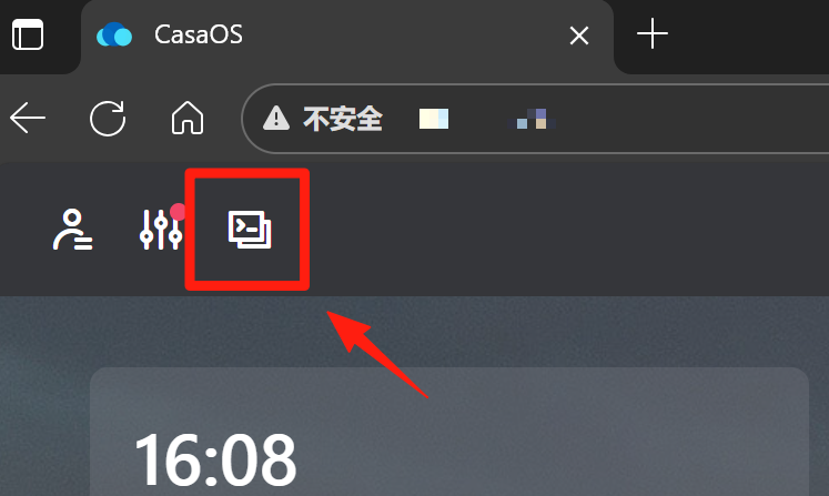

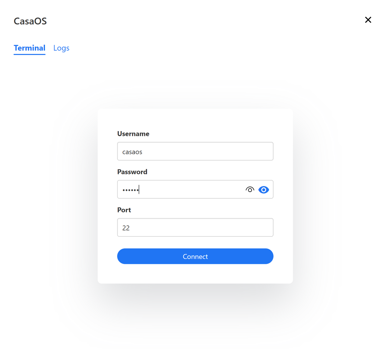

Access your device via Terminal.

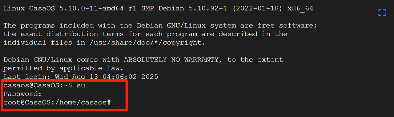

Switch to root mode
su
Run the command
lspci
You should see the Intel Device listed, confirming it is connected to the ZimaBoard.

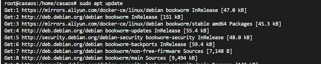

Update package lists:
sudo apt update

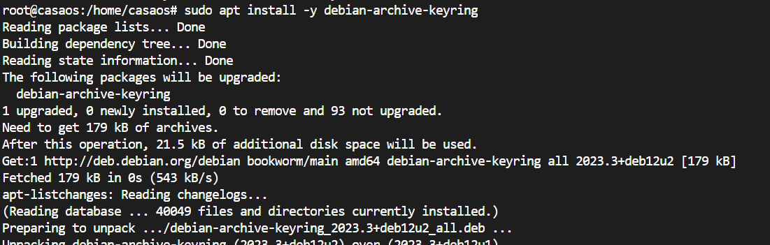

Add the Debian archive keyring:
sudo apt install -y debian-archive-keyring

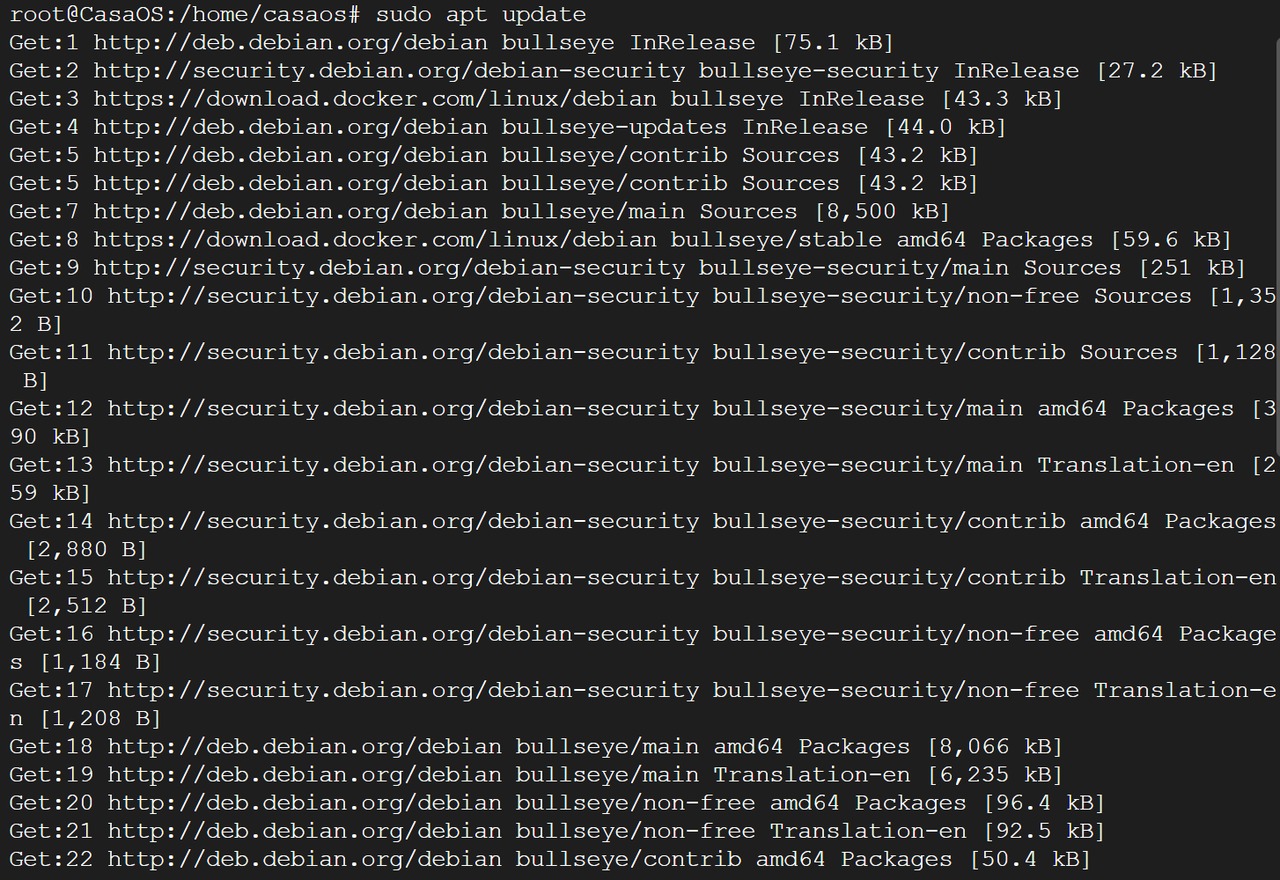

Update package lists again:
sudo apt update

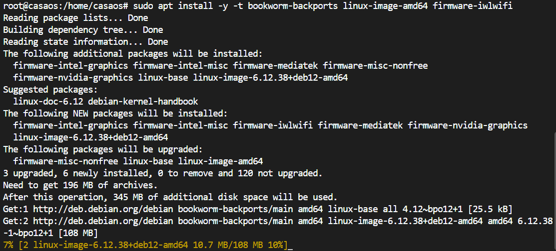

Upgrade the kernel and install firmware:
sudo apt install -y -t bookworm-backports linux-image-amd64 firmware-iwlwifi

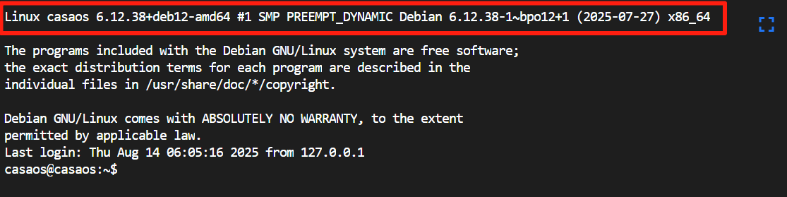

Reboot:
sudo reboot
After rebooting, confirm that the kernel version is 6.12 or higher.

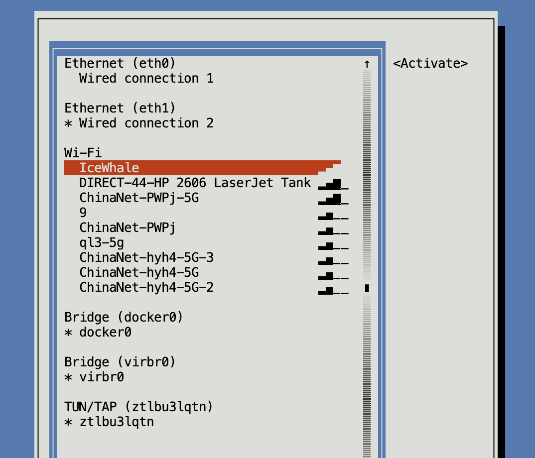

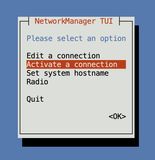

Step 3: Connect to Wi-Fi using nmtui
We will use the nmtui tool to connect.
sudo nmtui |
If the system does not recognize the nmtui command, please refer to the FAQ section for installation instructions.
Select Activate a connection.

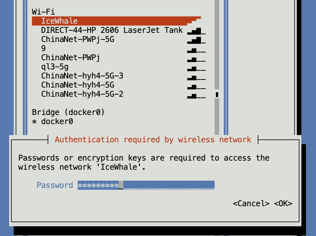

Choose your Wi-Fi network (SSID).
Enter the password and press Enter.

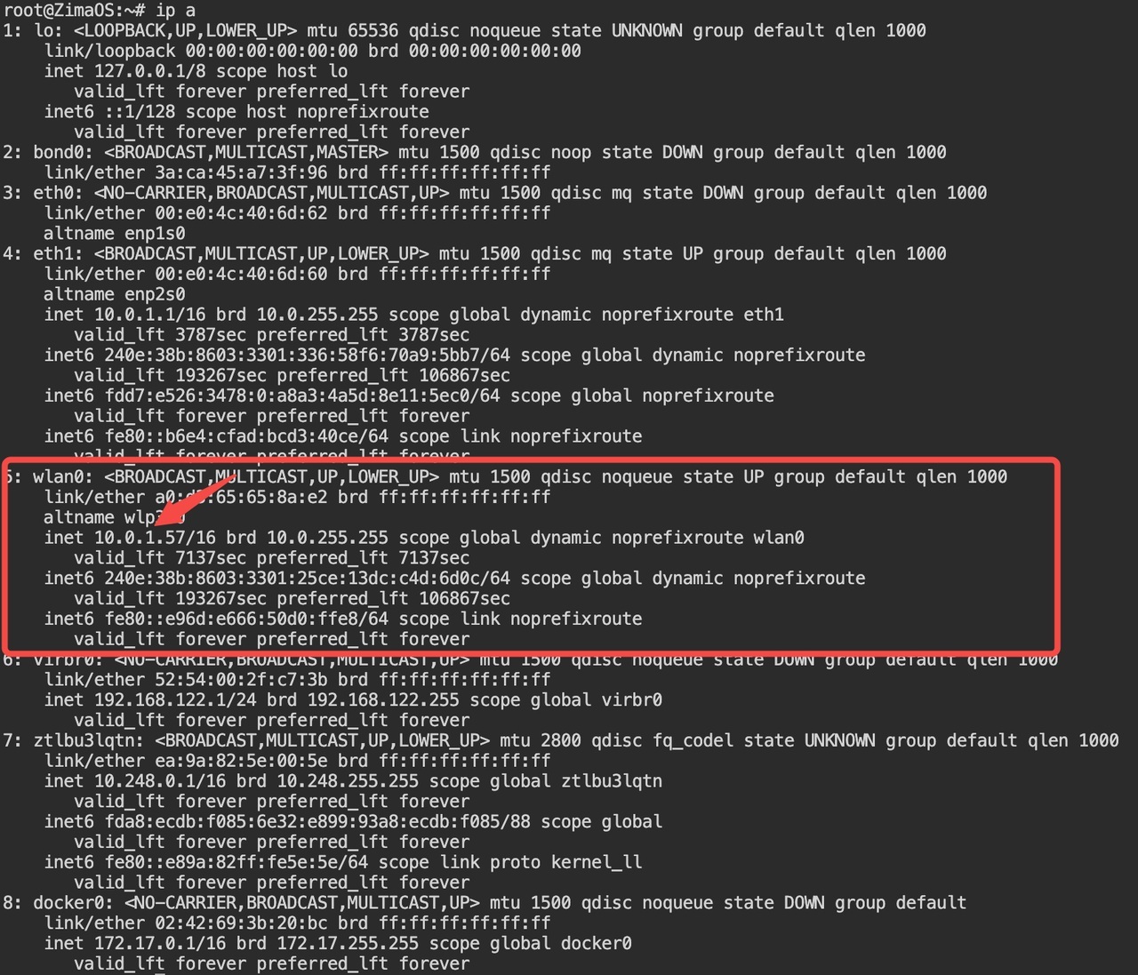

Verify IP address and connectivity
Save & Exit thenmtuitool and usingip ato check the status of your wireless interface:
ip a |

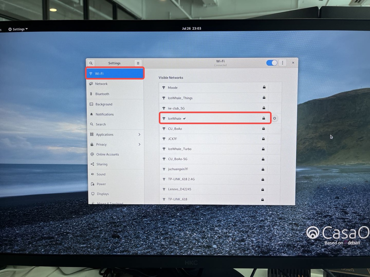

If you are using the GUI version of CasaOS, simply open the Wi-Fi menu and select your desired network.

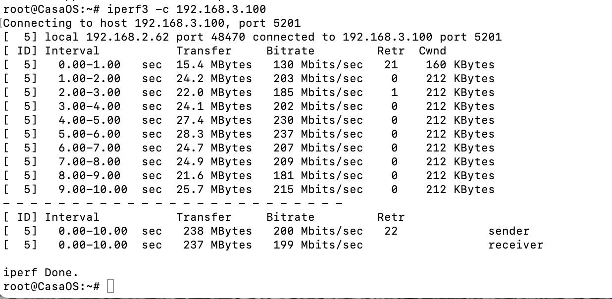

Network Speed Test from Zima device to LAN device

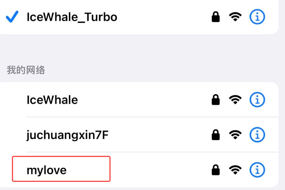

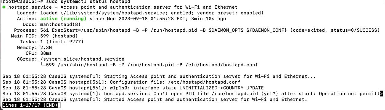

AP Mode (2.4 GHz Only)
- Install required packages:
sudo apt updatesudo apt install hostapd iw
- Configure the wireless network:
Edit/etc/hostapd/hostapd.confinterface=wlp1s0 # Replace according to your network adapter name
driver=nl80211
ssid=mylove # Replace "YourSSID" with your desired network name
hw_mode=a
channel=36 # Select your preferred channel
country_code=US
ieee80211ac=1
wmm_enabled=1
auth_algs=1
wpa=2
wpa_key_mgmt=WPA-PSK
rsn_pairwise=CCMP
wpa_passphrase=YourPassphrase # Replace "YourPassphrase" with your Wi-Fi password
logger_stdout=-1
logger_stdout_level=2
- Start hostapd:
sudo systemctl start hostapd
- Start hostapd:
- Test your Wi-Fi network by connecting from another device.
